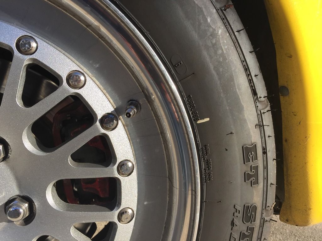

The car slung a wheel weight so last week i had the rears rebalanced. While on the balancer, we noticed the green dots on the tires didnt line up with the valve stems. We put new marks on the tires to see if they move. Noticed this today. ...alrighty then... the tires have been mounted for over a year.  lol

My rear tires move a little more than that every track day. I swap sides to get them to move back.
